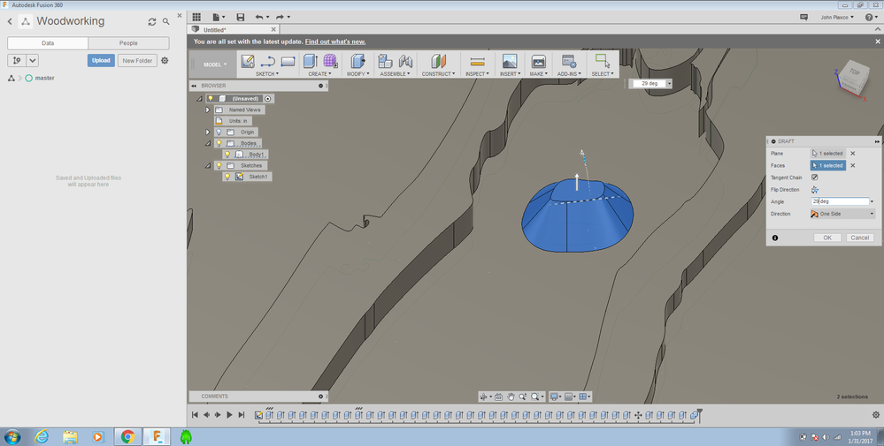

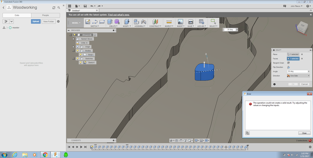

I am having trouble using the draft tool to do some v-groove carving. Before I even get to the CAM part, I'm having trouble getting the model right in CAD. Depending on which outline I select, there seems to be some kind of maximum angle the draft tool will accept, beyond which it gives an error I don't understand:
The operation could not create a valid result. Try adjusting the values or changing the inputs.
It tells me what I can try, but it doesn't explain why what I entered doesn't work. I also get:
Could not taper surface as requested.
sometimes.
I'm attaching some screenshots showing the draft tool perfectly happy with 29 degrees but error's on 30 degrees. There's nothing special about 30 degrees, other outlines won't accept 1 degree, some accept 45.
In case it's not clear from the screenshots, expanding the draft angle another degree isn't going to run the draft geometry into anything else. That said, there are situations where I'd like to be able to do that too.

From what I can see of your screenshots, it looks like you're trying to draft a shape with a base outline made with splines. Drafting the walls on a spline-based extrusion like that may not work because the changes in the "top" outline can make it difficult for Fusion to calculate; you may need to make your part with Loft instead, like in the screencast I made-

I wouldn't discourage from using whatever tools you have available at your disposal. It does seem like this feature could us a bit of resiliency. I can describe the challenge here as I understand, perhaps it will help.
As you draft or offset a sketch, the curvature of the spline/edge is going to increase/decrease. In the case where the curvature decreases, eventually becoming extremely tiny, it can be hard to generate geometry. Think BREP geometry with a radius out to the E-7 decimal place. This is why looking at the curvature comb can be a helpful task. It's not always a solution...
Often tiny curvatures will cause the body to self-intersect in other areas which can also be problematic for the geometry kernel and cause failures.
I'd love to see more for these types of issue. However, if you're importing the sketch geometry, there could be just one little hiccup (that isn't even visible to the eye) that causes the curvature to get hairy at a very small draft angle/extrusion distance (offset distance).
If you have a chance to share the design with us, I would be happy to take a look. I can't make any promises for a solution, but I'm happy to try.
