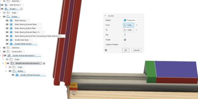

I'm trying to do an align operation.
I start by selected the center of the bottom of a vertical aluminum extrusion.

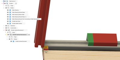

I then select the desired destination, which is the center of the flat top of another object.

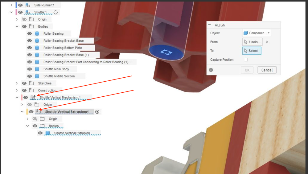

Having selected that destination the align dialog is ready for me to click the OK  button.

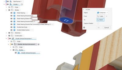

But after I click the OK button the dialog disappears (as expected) but nothing happens. The selected object
doesn't change position, it NOT aligned as requested. There is also no error message or anything
to indicate why it didn't move.
Now, you can see that the body I want to move/align is a sub-object of the component that I want to move.
Is that the problem? What do I have to do to make the desired alignment?

likely this is because the components cannot move.  I see that "shuttle vertical extrusion" is grounded (the little anchor icon):
I cannot tell whether the second component is also grounded, but likely that is the case.
Share the model here and someone can take a look at it.
