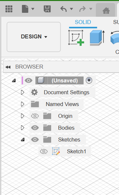

I am very new to fusion, how can I extrude these as two different faces (one goes furthur out than the other one)

Ok - how do you extrude this?
You can only extrude a closed shape and these turn pale blue inside which is what you have.
Go to Extrude on the menu or hit E.
Select the first area to extrude.
The solid is created but the sketch will be hidden, so turn visibility back on in the browser tree - the Eye icon.
Hit E and extrude again the section of the sketch you want.
Make sure the operation is set to Join.
There is your camera shape.
Cheers
