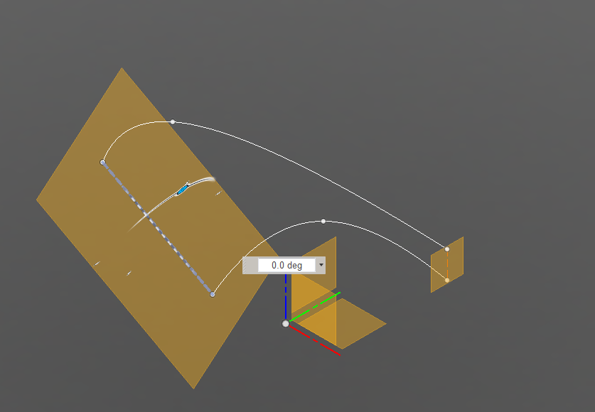

Also, the video in both of these posts seems to not match the title.  I don't see any workplane commands at all in the video.  Did you maybe mistakenly post the incorrect video?  I have the model, though, and I think I understand the problem:
This is the computed state of the plane:
And this is the state of the plane in the command:
They are off by 90 degrees.
This bug has been fixed in the latest version of Fusion, and will be available in the next update.
