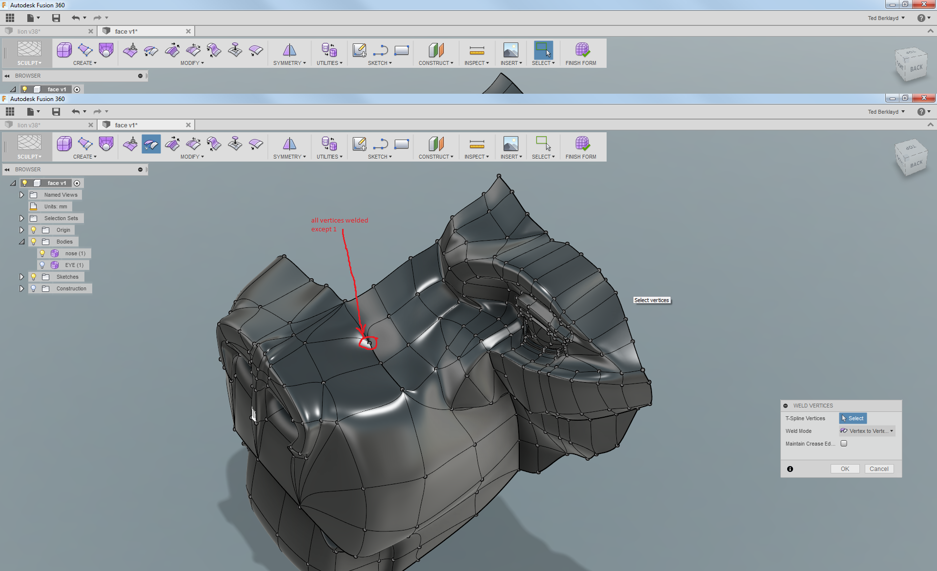

I have two bodies that were both created using the model tool that individually have smooth/round edges. I've tried to connect the two bodies every which way I could (bridge, weld, merge edge), and in every case when I connect two vertices in one particular area in the middle - the models unsmooth, and turns into that jagged wire-frame look. Both bodies are pretty complicated, but the point of connection is pretty simple, with 8 edges on each side lined up near perfectly next to each other. Usually this happens if the bridge creates a model with self-intersecting surfaces, or broken twisted things, but that shouldn't be the the case here. I've tried hitting finish form to check for any self-intersecting surfaces in the models individually, and combined as one of those ugly wire frame things, and there weren't any. Is there any way to fix this/identify what's causing the connection to be unresolvable?

Thanks for your interest. Attached please find 3 screen shots, 1) the edges i'm trying to merge, 2) being able to weld all but 1 point with no issue; and 3) the result after welding the last point.

I figured it out! as I was welding, the models changed slightly, causing overlaps in the corners of the eye, using the repair tool and a lot of hunthing and pecking I was able to resolve all of them, and it returned to it's regular shape all connected!

While you might have been able to get you model to compute I am afraid that this is going to happen again.
The reason for that is that you are using triangles in your model. While you are getting away with that at the moment, this is likely going to bite you again.
T-Splines are happiest when you are avoiding triangles altogether. Triangles are evil! Quads and 5-sided polygons, but really mostly quads is what keeps your models stable with smooth surfaces.

Thanks for the note, I had no idea. So what do you do when you need a triangle shaped face, do you just keep an extra vertex close to one of the legs of the triangle? I end up with these because i'll be trying to join some planes/faces that partially overlap, so I'll weld 2 of the corners of one of the face together.

You will have to point out areas where you think you need a triangle and we can point you in the right direction. I have a little bit of experience with T-Splines in Fusion.
Another observation I made about your model is you are using the face modeling method used in polygon modeling apps....that too is a very bad way to work with T-Splines in Fusion.
Let me explain why....When you model with T-Splines in a closed shape the curvature is continuous across the shape. When you face model it is not because of the edge curvature controls...and although usually when you join T-Spline patches together, Fusion re-approximates the curvature correctly. But if the joining geometry is (for lack of a better term messy) the curvature is trashed and there is no real way to recover from this state. Based on the current topology of your mesh your going to have a lot of messy geometry. Your topology in a lot of areas does not flow with the forms, this adds another layer of problems with surface tension. So all in all your current workflow and topology = migraine headaches. I only tell you this because I have been there before and there is nothing worse then pouring blood, sweat, tears and life hours into a mesh that's harder to fix then starting over.
