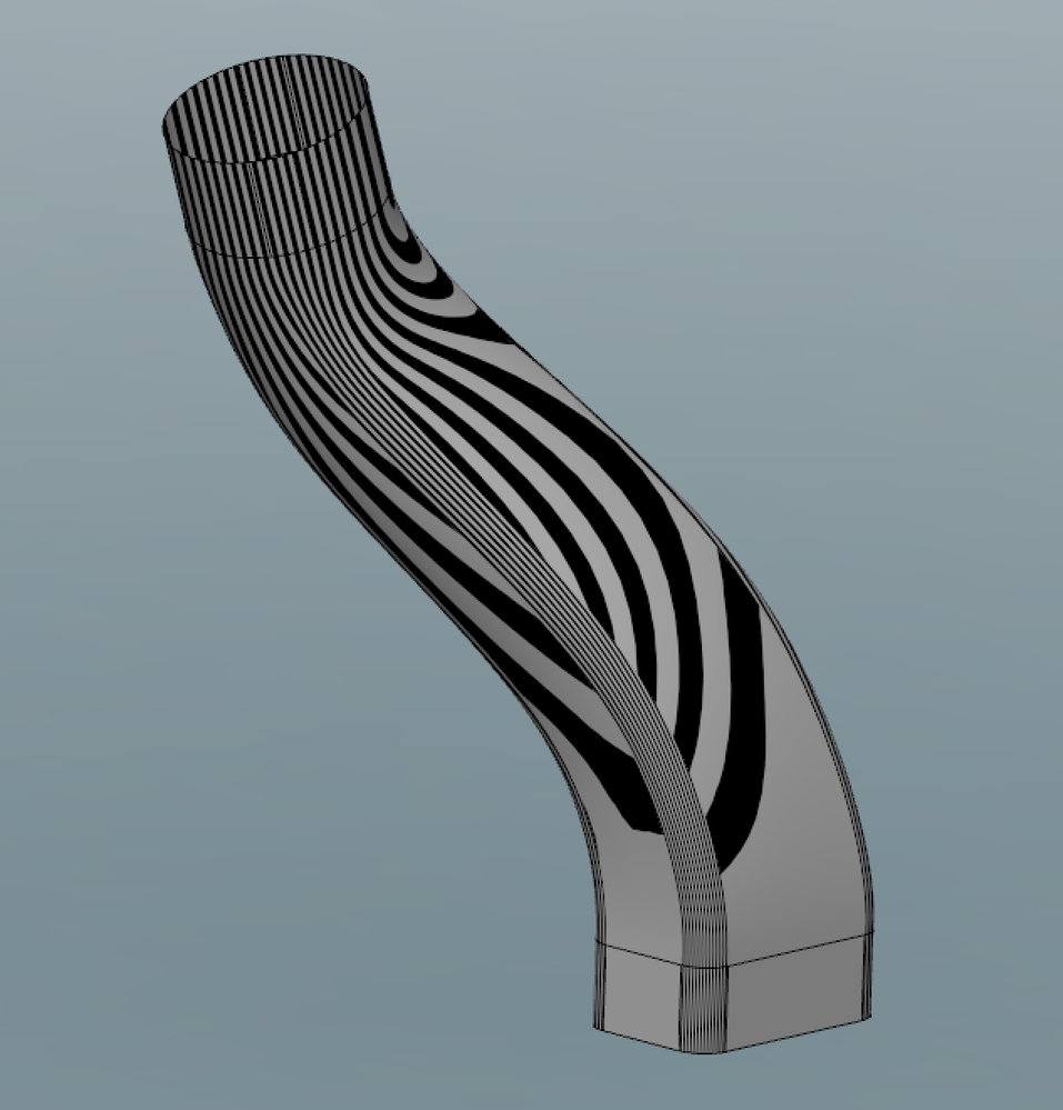

I'm working on learning this software. I don't think Fusion has bridge curves where you can project lines on a pipe and then connect those lines with a simple bridge curve that is basically a 3d curve with an input you can use to dictate the amount of tangency curve you want?
In the uploaded file I had to apply a 'length dimension' to the spline curve to control the irregular shaped pipe. Now what I'd like to do is build some isoparametric curves on the surface of the pipe or just project lines onto the pipe so that I can build bridge curves which will be the guide curves for the loft command.  Is this possible in fusion?  I'd like full control of all these bridge curves I build as opposed to somehow building this shape in the sculpting area.

TrippyLighting
Look at lofting with rails. Unfortunately my screencast are not uploading at the moment.
Model is attached. Just walk through the timeline. I changed the tangent constraints in your sketches to smooth (G2).

Thanks, you helped me out a bit, BUT that spline curve you created is on a single plane.  I have uploaded a file for something I need to be able to produce.  I need to be able to generate a bridge curve b/w each fillet on the bottom piece to the corresponding line on the top cylinder so I can get a nice flowing look b/w the bottom square piece and top cylinder piece.  I need to create a bunch of these bridge curves/guide curves so I can slowly build the surface.   Is there any way to create a 3d spine to connect the bottom fillet curves to the curves on the cylinder in my model?

TrippyLighting
You mean like this ?

TrippyLighting
Yep, that's exactly how I created the spline!
When creating the loft I used the spline as a center line spline. It is counterintuitive that a spline that does not actually sit in the center can be used as a centerline spline but it works.
Also, when selecting the loft profiles in Patch mode I make sure to turn of the sketches so I select surface edges and not line segments or a profile in a sketch.
Then I also set the start / end. condition to G1 or G2.
That only works if the loft surface has something to be curvature continuous with and the cannot be a line segment, it must be a surface.
If the rounded edges on the rectangular profiles would be little spline segments with G2 tangency then the curvature of this thing would be even smoother.

@Anonymous A word of caution here. Never split a surface if it can be avoided. Splitting surfaces the safest way to have Fusion 360 or actually the ASM Kernel create crappy surfaces.
In this case the curvature is fine, but make sure to always check curvature with the curvature comb if you need to split a curved surface.
in this case you split the cylindrical surface with the open box to have edges too select for your splines to be tangent to. You could have just as easily split the open cube with the cylinder and have left the cylinder surface intact.
