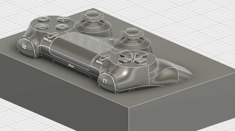

Hey there i'm new to fusion and 3d cad modeling.
I'm trying to make a box for my ps4 controllers, like this one https://www.inventables.com/projects/xbox-one-controller-box14
just for ps4.

so when i drop this model on a box:

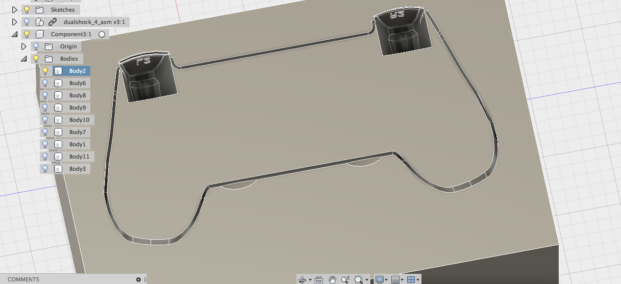

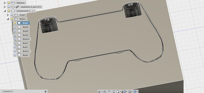

and when i cut this out with the combine tool or with the boundary tool i end up with this:
this is still one body and not the thing in the middle is not a separate body as i hoped. at some points at the shoulder button parts the inner part is still connected to the outer side of the box ( because of the gabs) and there is the connection at the bottom.
The only way i came come up with, is to patch the holes with the patch tool and to make them to a body use the thicken tool.
But when i try to cut with this patted holes i get this error
So im still started with fusion but i don't know how to separate the inner section or an other way to close the gabs without patching.

Many of the small openings in that the controller body don't have to be patches, they can simply be deleted. Some of the larger, more complicated openings will have to get patched.
TrippyLighting
in reply to: Anonymous
I've downloaded that looked at the GrabCAD model. While the project you have in mind appears to be easy to the beginners eye, this is not a beginners project by any means.
IN order to combine/cut the controller away from the box yo'll first have to make sure you have a solid body that is not a shell, does not have ant nooks and devices where sliders of material are left after combining. I've been able with a lot of work to get the important bottom half to a solid body but it took a several approaches to get this into a solid with no openings and without unnecessary features.
