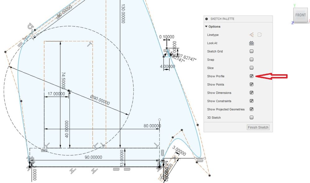

I have a sketch where bounded areas do not shade blue and are not therefore selectable for extrusion. Even if draw a circle on the origin! If I create a new sketch everything works fine. Have tried restarting F360.
Yes, there are other elements in the sketch but everything is Fixed (shows up green). Is there anything I should check that might explain the lack of shading of bounded areas? (And actually it's not the very first time this has happened.)
(No selection filters are applied.)

Attach the file to reduce the guessing 😀  File/Export/Archive file *.f3d

Show Profile on Sketch Pallet:

Amazing!
Thanks so much.
Didn't even know that checkbox existed!!
