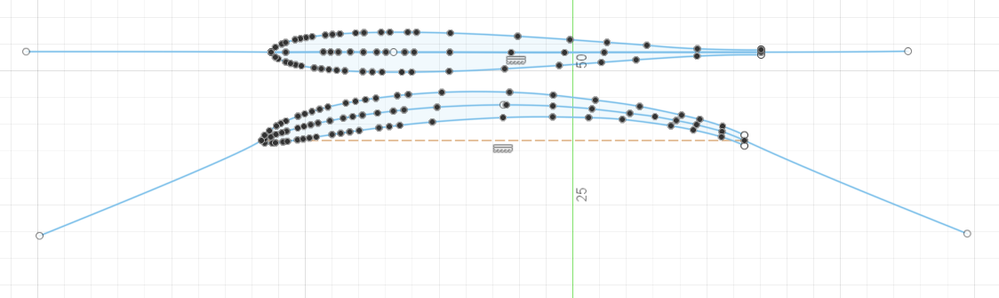

the tool looks not bad, i had to test a little bit more.
There is one Question. Is there a possibility to open the trailing edge from the profile to an given measurement.
If i construct a wing to manufacture a laminating form i need not a trailing edge with "0".
Normally i draw a line with the measurement i need cross the center then i turn uper and under Spline around the center point at the leading edge to open the profile at the end. Then i set the leading edge to tangential so that the nose radius goes not to the inside. At the end i close the upper and under spline with the line at the trailing edge.
At the end it looks like the profile at the picture.
Can you do this automatic with your tool over a query about the thickness from the trailing edge ?

Hi, yes, that's the "Min Thickness" option which is available in the current beta release.

You might also like the "Camber line" option as well, which inserts the camber line along with extended ends, which can be used a the mold parting line (e.g. if you're making these from pre-preg carbon fibre).
