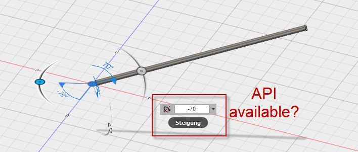

cool stuff guys 😃 After watching most of the tutorials in the fusion help, I think I will have to create a component for the tubes. And create it similar to @chrisplyler have done that with the construction lines. And then fix the end of the construction line (tubes) with a ball joint in the middle. After doing that I can easily move the tube with the mouse and the angles are displayed. Somehow I have to find a way to adjust the angles with API. And the method of adaptive flange created by @wersy has to be integrated somehow.
Can i display somewhere the angle parameter of the ball joint? In Revit I have lookup tool to look into the database names and values
