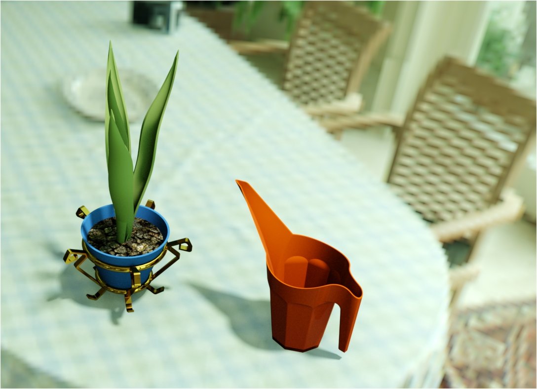

I'm no big Renderman, but see attached a picture, that's been done with Showcase 2015.
I've found a flower pot in Grabcad, and a HDR scene in Navisworks. Both could be combined with the watering can.
IMO, this is far beyond the rendering capabilities of F360.
If Autodesk really has made a decision for not further developing Showcase, then there seems some work to be done in other software.

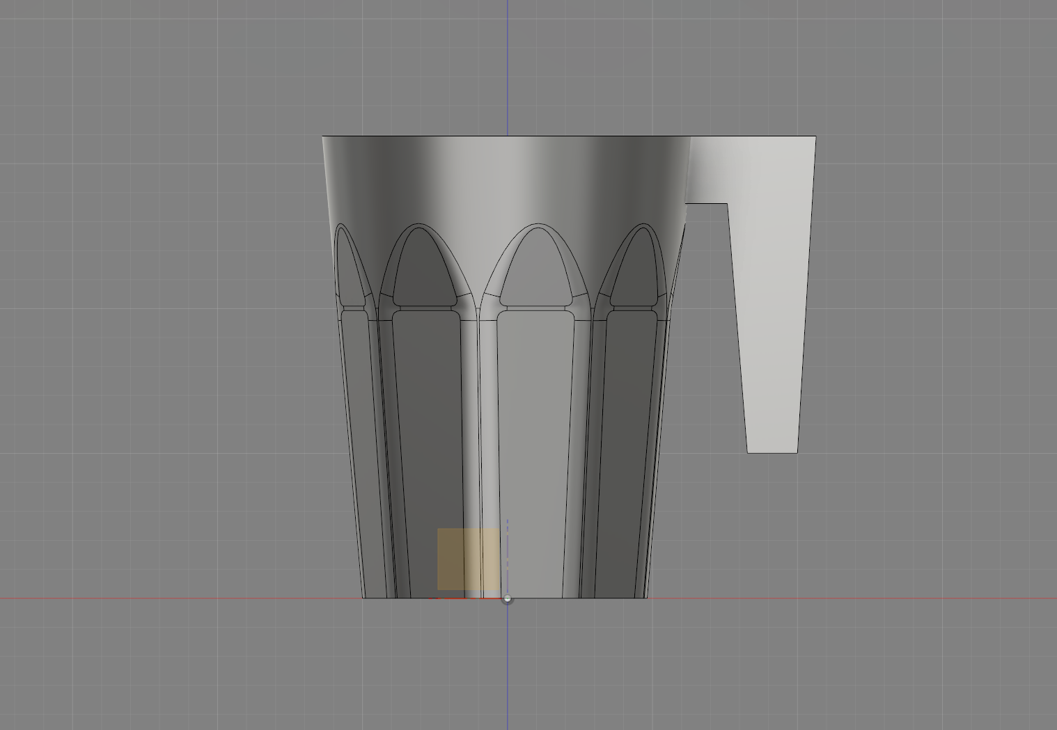

I might suggest a different rounding strategy as well so you can prevent the undesirable side effect of the approach you used.
Check this file: http://a360.co/1AicNxz
Take a look at the image and pay attention at the side profile/edges of the vertical faces.

So here I rebuild the design for you from scratch.
http://a360.co/1zgUWvW
The only shelling/filleting problem I encountered was this edge:
So I rounded this edge after doing the shelling - not perfect but in this area doable.
So besides that one fillet related shelling problem the design tools in Fusion are sufficient to build somthing like this easily.

cekuhnen
I did not know this should be tangent - I just roughly rebuild the forms.
This would only require a spline for the left to be adjusted. Not a big deal.
Project the red line onto the spline sketch so you can match it easily.
