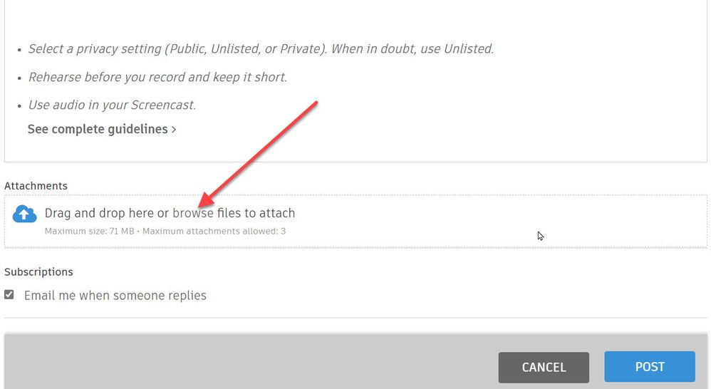

There is no Bend function for solid non-sheet metal bodies in Fusion 360.  If you create a sheet metal body, you can use the Bend command.  Since you are coming from a STL file I doubt you can convert it to sheet metal to use this tool.  It would be best just to model the component and sketch in the bend you need.  If you attach your model the forum users can probably give you a hand.  If you do not know how to attach your Fusion 360 model, simply open it in Fusion 360, select the File menu, select Export and place the file on you hard drive.  Then use the Attachments section of a forum post to attach it.

The forum users need your Fusion 360 model.  If you only have an STL file, then attach it.  There are ways to bend solid models but we really need to see the file to tell you how to do it, if possible.  If you do not know how to attach your model, open it in Fusion360, select the File menu and then choose Export and save the .F3D file to your hard drive. Then use the Attachments section of a reply forum post to attach it.  If you have trouble attaching it, zip it first.

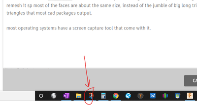

most operating systems have a screen capture tool that come with it.
