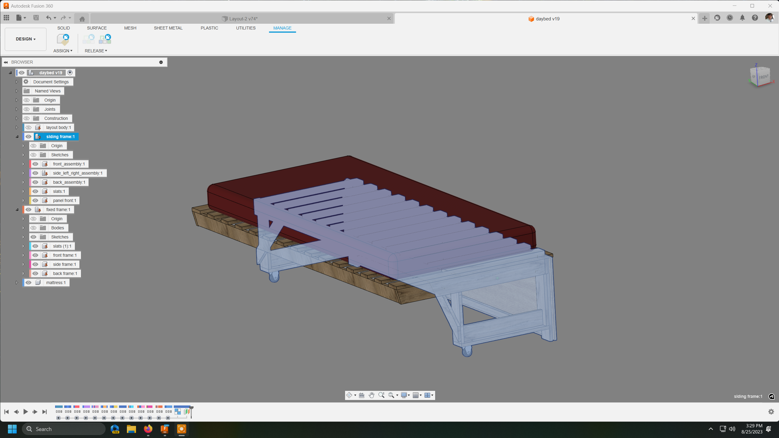

Working in a custom fab shop has challenges that I wont even begin to get into on here.
But please allow me to add my .02 cents to the conversation. 🙂
What helps me is making some reference notes to follow as I move along in the design process notes that will detail out rough sketches, type of component to be designed with references or links to google searches, color choices, materials, etc.
I wish there were a way to attach said notes to the design, either as an embedded file or a link to an external file (text, pdf, excel spreadsheet, or image)
Having pregamed the design process makes the flow a lot smoother, for me.
I begin by creating a series of sketches spanned across however many will give me the profiles I'll need to generate each assembly/component group into.
Then I go nuts creating and naming components until I have what I need.
For example, I'm redesigning the interior my Shasta Starflyte camper.
I have a canvas for each of the 3 views of the camper from which I create a master component for the body.
Then each subsequent item in the camper is in it own component with a number sub-components underneath the parent level component, or depending upon the complexity of each component I may create that part as a built in place design or as separate file and insert it into my master design as a derived component.
This helps me keep things tidy and organized and lightweight, editing a part as its own entity helps keep the master file easier to manage.
A lot of it comes down to the scope of the project, how involved it will be and how many changes I expect to be making in the future.
