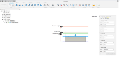

I've done some more troubleshooting and it looks like I have the same problem as this guy, however I don't have the
'Clearance Height' option as shown in this screenshot, anyone know where it may have been relocated to?

Work around the heights tab and make sure that retract, Feed top and bottom heights are properly defined to avoid this type of direct plunging into the model. I hope you can reselect the heights tabs to resolve the issue or you can share the CAM file with us.

@tkqe  If you are using the new NC Program option it's under save retracts. EDIT This assumes you're using the Mach3 post.
