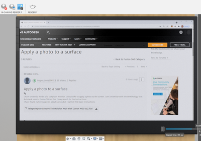

I have created a model of a computer monitor. I would like to apply a photo to the screen. I am unfamiliar with the terminology that Autodesk uses in Fusion 360 so that I may search for the instructions.
I have found numerous posts about canvas but I cannot find basic instructions.

The tutorials / command you want to look into to do this is under the Insert menu- Decal.
Canvas really refers to images placed into the workspace to serve as design references. Decal is what you want if you are wanting to create a rendered image with a photo or graphic.

upload your photo as a "sticker" on the screen surface that you want to illustrate. but it is better if the area is its own area and not combined with the frame of the screen. BR mango

@Inspections_JCH
See Attached.
