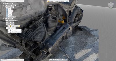

Here is my problem:
While using canvas even when it is in front of the camera I can't make it completely opaque. It never fully opaque  even with 100% opacity. Specifically, I want to be able to see more of an image than of an object.
Let me demonstrate:
Here is my setup. I have an object (imported mesh) and I have TWO canvases perfectly aligned with an image object and named view. One in front, one behind. I was experimenting with what is the best. Here is how it looks from the side:
When I look through the camera with both enabled I See this:
When just front is enabled it doesn't change much:
Just back one enabled (with Display Through) it makes it worse:
Here is how image looks without an object:
So, basically I want something closer to what I can do in blender in a similar situation:
Is it possible?

khe khe. I think I Found an answer to my own Q.
So, basically, it seems like it's the edges that shine through the canvas. Not sure why that was a design decision on Fusion, part. But at least I have a shortcut to switch in and out of it.
