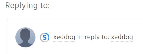

By the way, when you post replies to a forum post, it is important that your select the Reply button on the post from the person you are responding to.  You, for example, selected a post written by you, so you get this screen capture below.  The reason this is important if you have more than one responder, which you do, no one knows who you are addressing your comments.
