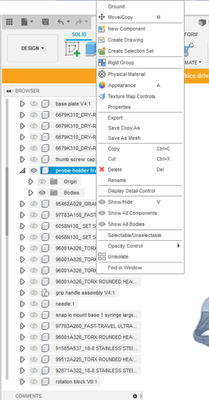

jarrod.2.cornejo
Why isn't the "open" option available when I right click a component from the assembly in the browser? I want to be able to open component files from the assembly to edit their designs. Any advice? Thanks!
Message 9 of 16
laughingcreek
your screen shot doesn't show any external components.  in your case there isn't a separate component file to open, it's contained in the model you are currently working on.
Message 10 of 16
jarrod.2.cornejo
Thanks. I got this from a SolidWorks Pack and Go. I extracted the file and uploaded all of the part files to Fusion360; I selected the assembly file to be the top level assembly. How do I link the components from that top level assembly to the external component files?
Message 11 of 16
jhackney1972
The process to make any or all the components External files you would use the Save Copy As command.  In your previous screen capture you can see this command.  The problem is you will have to build the complete assembly over again by using the Insert onto Current Design, you will find in the Data Panel when you right click on any External Component, into the assembly.  This is a lot of work, and a real waste of time, where the Isolate/Unisolate command, mentioned earlier, will do what you need with your present assembly.  Now if you want to build a different unique assembly using your current components from this assembly, it may make more sense to externalize the components.

Message 13 of 16
jarrod.2.cornejo
I agree with @jhackney1972 , compiling all of the external parts into one assembly file on import really has no benefit. Typically, its best not to modify individual parts directly in an assembly as it gives little control over individual parts and it creates two separate tasks: modifying both the assembly part AND the external part file. Better to have an assembly that is synched with the individual external part files so this process is streamlined and easier to control. Not sure why Fusion360 was built that way, creates more work for the user.

jarrod.2.cornejo
@TrippyLightingthen it seems I wasn't being clear. Let me re-phrase the two problems I'm facing:
  1. When I try to import an assembly file AND its individual part files, it seems like only the assembly imports and the individual part files are left behind. I tried to import all the files extracted from a SolidWorks Pack and Go into Fusion, there is a dialogue box that requires me to select which file is the top level assembly. Once I've selected the top level assembly, it seems like Fusion only imports the assembly file and NOT the individual part files because none of the individual part files appear in my team folder. That leads me to believe that the components in the assembly file are not linked to their individual part files. Which leads me to the next problem...
  2. Fusion360 does not let me open individual part files from the imported assembly so they can be edited. When I try to right click on a component to open its individual part file, there is no option to "open" that file (I posted a screen shot of this earlier in the thread). @TrippyLighting recommended isolating, editing, and then un-isolating a part in the assembly file itself but does that edit sync with that component's individual part file? Or do I need to open the individual part file and make the same edit again? Based on @jhackney1972 reply, it seems like I would need to rebuild the entire assembly again to get this functionality which, in his opinion (and I agree), is an unnecessary amount of work. Is that true? My ultimate goal is to ensure edits made in an individual part file are reflected in the assembly or vice/versa.
I hope this provided some clarity. I'm open to suggestions! Thanks!
Message 16 of 16
TrippyLighting
Your observations are incorrect.
A pack-&-go includes the assembly file, which only includes references, or "links" to the part files. If you move one of the part files to another folder SolidWorks will not find it and will ask you to pint to the new location so it can re-link the file. Assembly files and part files are distinctly different files in SolidWorks.
A pack-&-go automates that process. It creates a duplicate assembly file and duplicate part fiels and makes sure the part files are properly linked to the assembly file.
Fusion 360 paradigm is different. Fusion 360 does not separate between part and assembly file.
You can build a complete assembly in a single design file. This was how Fusion 360 was initially designed.
Later linked components were added.
When you import a SolidWorks pack-&-go all part files will be incorporated into a single Fusion 360 assembly file.
If you want to edit a part file, just find it in the browser, activate and isolate.
I've worked with SolidWorks since 1998 (and still do) and Fusion 360 since late 2014 😉
