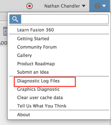

@Anonymous Can you share your diagnostic log files with us?
There's a suggestion in the below link rename the .dat file for the data panel. Can you give this a try and let us know if it helps?
https://knowledge.autodesk.com/support/fusion-360/troubleshooting/caas/sfdcarticles/sfdcarticles/Data-Panel-does-not-function-in-Fusion-360.html
I hope that helps! Let me know if you have any questions.

re installed saturday and everything was good to go. All files back.
Now today Im getting the error about "Terms have not been agreed" Tried to remove the file per the instructions in other posts (i do not find the path they are pointing me to)
tried to click the error button and fusion does nothing. Spinning beach ball.

@Anonymous Thank you for the update and I'm sorry to hear you running into additional issues. It looks like you're running on MacOS. Do you run anti-virus software on the computer by any chance? It would be helpful if to take a look at your diagnostic log files. There's a command in the help menu if you can share them with me.
To resolve the error message, can you try the following steps:
1. Close Fusion 360
2. Browse to the below directory
Windows:
C:\users\***\appdata\local\autodesk
How to access hidden files and folders in Windows
MacOS:
MacHD\Users\***\Library\Application Support\Autodesk
How to access hidden user library folder in MacOS
3. Rename the Web Services folder
4. Restart Fusion 360
I hope this helps!
