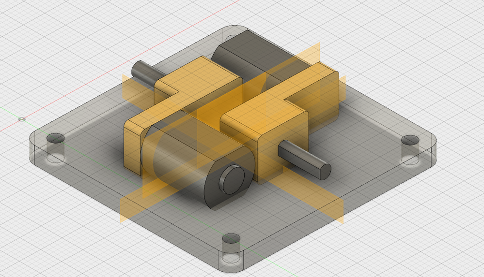

When trying to join 2 components I'm running into a few problems:
The components do not have any sides to align so I drew a few planes to mark there centers.
Problem is, I cannot align the components because they just leave behind the planes (or the planes move).
How can I align (and join) these components?

I suspect the problem is that the planes are not owned by the components.  The solution is to "activate" the component before creating the planes:
Once the planes are owned by the component, they will all move together.
Jeff
