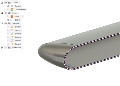

Hello - I'm experimenting around with few airfoil/endcap designs and wondering why these surfaces won't thicken. I'm somewhat new to surfacing so maybe due to this type combo of faces it's just now possible. The model stiches fine so more curious than anything. Trying to achieve a wall thickness of between .2 and .4mm for possible 3D-Print project in the future.

TrippyLighting
Yep, not a surprise!
There are two issues that make this seemingly simple geometry very challenging:
1. You are using fit point splines, which in FUsion 360 are 5-degree multi-span splines. These harsh transitions are where the rails are and they over-consrtin the surface.
2. Te training edge of the loft is a point, which means you are lofting into a singularity.

TrippyLighting
If you want to get into technical surfacing, here's a link to the Autodesk Alias Theory Builders.
I recommend this as a basis for anyone wanting to really understand lofting in Fusiosn 360 as it creates NURBS surfaces, but the documentation in Fusion 360 is kept artificially at the layman level.
You can create smooth surfaces with Fit point splines and in many cases, they are also my go-to tool, but this wing tip is not simple. Unless you absolutely must to have completely uniform wall thickness I'd actually create a second loft for the inside and stitch that to the thickened inside of the wing.
Using Control point splines will not automatically create better surfaces and comes with its own challenges.
I would try to create the wing profile with 2 splines only, one for the top and one for the bottom, or perhaps even just one. Use as few fit-point spline control points as you can.  It takes a good bit of patience to manipulate the spline handles so the curvature combs are smooth. In that case-control point spline might work better.
The rails you used for the wing tip would really only have three, or perhaps only two spline control points.

davebYYPCU
I prefer one spline top and bottom, your leading edge radius is causing trouble.
Rebuilt as I would do it, won't thicken or shell, so fudged aproximate 1mm thickening.
Fusion Loft inherently wants to shrinkwrap in my experience.
Might help....

davebYYPCU
This tip has 3 rails, between each rail the surface seems to carry tightening (slight you can see them in the map) - that I see all the time.
In the Op's file he did not use the second sketch as a profile, and shows it better.
Message 11 of 13
TrippyLighting
Yep, that means you are over-constraining the loft and need to break the loft down into smaller patches.

rwetzler
Dave,
Thanks for sharing, very clever idea using the offset/split work around. Your geometry is a little cleaner than mine and looks nice. I played around a bit and found with your version I could thicken the stitched bodies in a range between -.4 to -.8, wouldn't however thicken with symmetry or positive values wouldn't work. Overall this is what I was looking for as 3D-Printed RC Plane model parts must be printed with extremely thin walls due to weight requirements.
