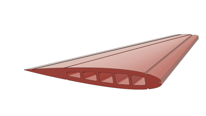

wersy
I've shown this before here, cut the ribs out of the solid wing.
And since spars and recesses are also needed, cut those out as well before creating the ribs.

wersy
Basically, I prepare the solid wing so that at the end you only have to cut out the ribs.
Simplified, without the feet.
And yes, you can see it flying here
https://youtu.be/NeTNCoNy144
Visual representation with feet.
For milling or laser cutting a DXF was exported.
