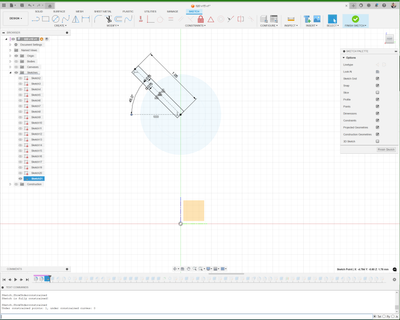

Normally I will learn a cad software in a couple days. Have been struggling making basic sketches for over a year and Fusion is wasting my time every single time I use it. What is wrong with my latest sketch? Sometimes I just enter the same dimensions in a different way and it will turn black. I have locked it to projected geometry because I thought this was one of the advantages with Fusion. How do I find what is wrong? What ever I do- as usual the sketch is over constrained and it cannot be moved around.

There was a duplicate construction line under this projected one.  Delete it and make the mirror line vertical to fix it.
If it was mine, I would only need the top projected line, - and yes that would normally be an acceptable workflow.  Duplicate overlaid lines will cause this sorta thing.
Can't see a reason for that mirror (deleted), and it would also contribute to sketch calcs that go wrong.

Ok. Let's fix your sketches.
You will find that when you struggle with constraints that this Text Command will be very helpful. This one on
sketch 2 shows 6 unconstrained points and three unconstrained curves. The offending points and curves are
highlighted. A "curve" is any line in fusion (annoys the snot out of me too). Construction lines must be constrained
in a sketch the same as other curves. (Haven't worked out why a CONSTRUCTION line needs a constraint but it
does).
This one needed the midpoint of the centre construction line coincident with the origin and the two marked points
coincident with the edge lines.
Sketch 17 looks like this.
You defined the distance from the side but not the top edge. And you also didn't say how far apart the points were.
Ok sketch 21.
Here is that pesky construction line constraint again.
Sketch 22. There is a saying in the forum - Blue lines in sketches should keep you awake at night.
Sketch 22. If you have a blue line it is not constrained. Move it an drag it to see which direction it isn't constrained
and give yourself a hint. In this case you did not tell fusion the length of the top line.
These points were also not coincident with the projected line nor did fusion know what distance these points were
from other geometry.
Sketch 25
Your square was constrained to the centre of the circle but fusion didn't know where the centre of the circle was.
You have to tell the software the dimensions, it doesn't always guess.
Sketch 26 look for every blue line and open circle. Construction lines count.
Sketch 35 - Construction lines count.
Sketch 39 - Construction lines.
Construction line Sketch 43
You have done something very strange with sketch 60.
You have a sketch on an offset plane that is fully defined to the midpoint of a projected line that runs along another
offset plane (0.5mm offset is a very exact but strange value) that intersects with a 3d sketch at right angles on
another offset plane?
I am not surprises you cannot work out how to constrain it as I have a headache just trying to work out what you
have done.
Here is my version of your file up until the abomination in sketch 60.

Ok. Now it works. I removed a ton of pink dots and features that Fusion had added for me and now it works. It is also wasting my time that I have to delete 30% of my sketches when Fusion adds stuff I never wanted. Thank you all for the help.
