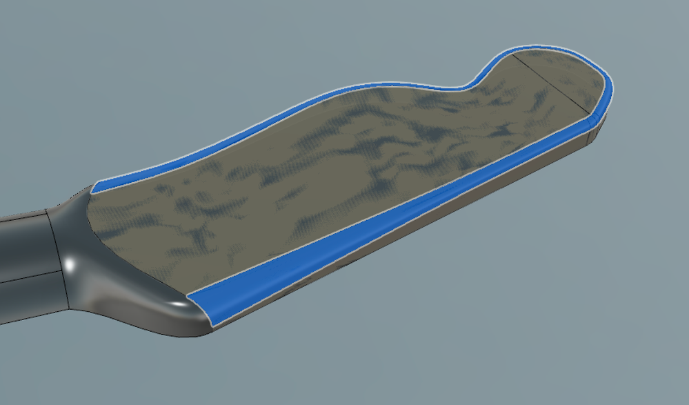

I first must tell you that I am a self taught beginner with Fusion 360 and 3D design in general. I am a High School technology teacher that is starting a STEM guitar building program at my school this year. I have been chugging along and learning the Fusion work space very well, but I have ran into a a problem that is causing me some trouble. I have created a general design of a guitar neck and have successfully completed the project using a CNC router. However, I wanted to create a more well sculpted neck to aid with finishing and that would require less sanding after coming off of the Shopbot. I have created the basic shape but can't for the life of me get the neck profile on the back to loft to where it meets the head stock. I am fully aware that this is a copyrighted headstock design from Fender and I will not be using it as our final design, but simply using it as a building block to secure the knowledge required to finish the design.
any help would be greatly appreciated.

SaeedHamza
I tried a workflow and got this transition, is it close enough? ( File is attached )
Saeed Hamza
Message 11 of 23
TrippyLighting
If you use a variable fillet radius and make it bigger toward the neck that blend should actually look quite well!

SaeedHamza
Can't do that, because I used a loft with both profiles set to tangent, so I can't use fillets on them, it won't even let me chose them to fillet them

TrippyLighting
Can be done if we take a little creative freedom.

SaeedHamza
Oh, yes this originally was done as a fillet
I thought you were talking about these edges
