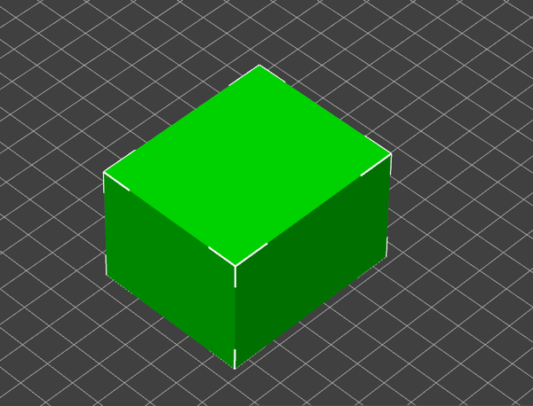

wersy
@davethomaspilot9V8SL  schrieb:
I think the question is pretty clear.
Solid box.  How to make it hollow except for adding infill.
Do I need to create a design of a cube  and upload it to illustrate?

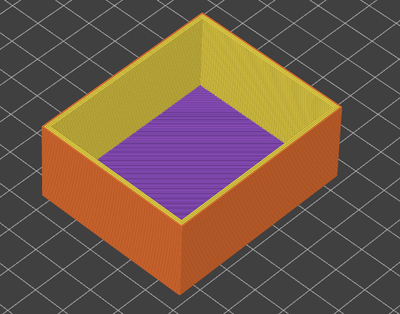

This is a closed box
This is how you can slice it with your slicer for printing.
