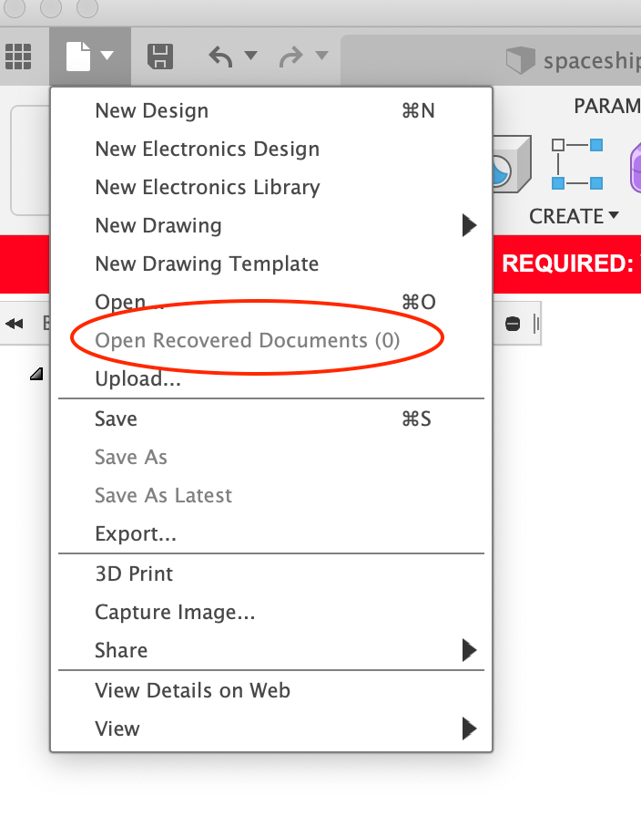

if there are any recovered documents, this command will re-open  the recovered designs dialog:
