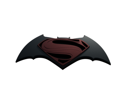

Here is my Batman vs. Superman logo with the backgroun knocked out from the cloud render.
If you don't have any more questions on the subject I'll mark the issue as "solved"
Colin
