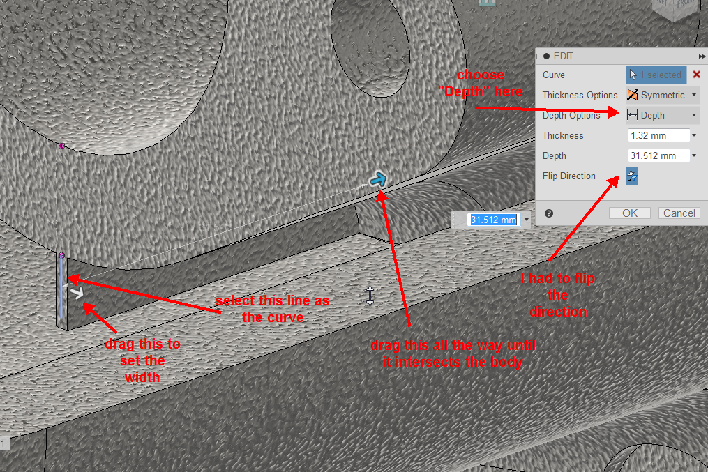

Hi Jeff,
I have attached the pic. This is the V-Belt drive from the library. I was going through one of the forums, where someone said that the rib feature "To Next" is buggy.

next, sketch on this plane. Use Project Intersection with the body, convert that intersection to a construction line, and create a line extending from that projected line.  It doesn't have to go all the way to the other side of the opening:
Then, use Rib, with a couple of important settings.  Use the "Depth" option, and flip the direction.  Then, drag the width however wide you want it, and the depth all the way until it intersects the body:
This is the result.  Hopefully, this is what you were hoping for:
