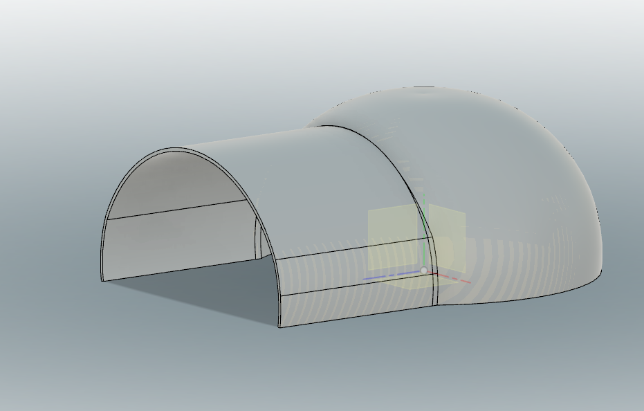

Hello!
When I combine these two bodies:
This sphere appears
What is wrong? it doesn't look like a new body.  How can I get rid of it? It happens the same if I choose "join" when extruding the arc.
Link: http://a360.co/2pMSQEP
Thank you!

First thing I notice is that your Sketch1 is not fully defined.
When I add dimensions to the arcs - they do not appear to be logical (manufacturable) dimensions.
Next I notice in your image that the faces are not symmetrical?
Is something like attached what you are really after?
jeff_strater
Definitely, @TheCADWhisperer's design is much cleaner and simpler.  If that meets your requirements, you should do it that way.
However, your method should work as well.  What you see is a graphics glitch that we will look into.  The geometry is not really there (if you export to STEP and re-import you will see that the model is OK).  However, the results that you get are clearly not acceptable, and shows us a bug, which we will look into fixing.

Thank you! I will adjust accodring to my measurement based on your drawing 🙂
