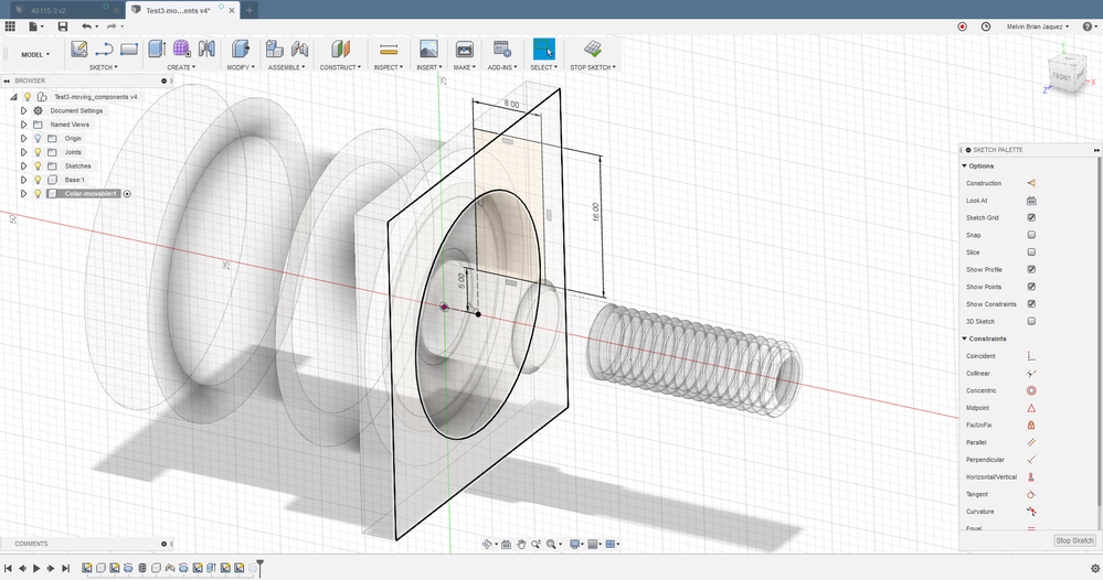

In the attached Test2 file the Base component and Collar are in the position before modifications to the Base.
In the Test3 file I modified the Base (extruded square feature) and want to edit the Collar constraint to constrain it to a new point that I created on the square face in the center.
When I try to do that I don't see the square and the new point I created on teh Base because they are further in the timeline.
The key for me is to always see the latest version of assembly components when modifying other components of the assembly. And to have the component/sketch that I am modifying in its assembly position, not moved "back in time".
Message 11 of 24
melvinbrian3d
i hope i've understood correctly,
this is what you want?
here is the Version 4 with the sketch and revolved moved further in time and constrained with the new point of the square sketch.
MelvinBrian3D

Hi, I re-define the collar sketch plane to the new point you created as you can see in this picture
