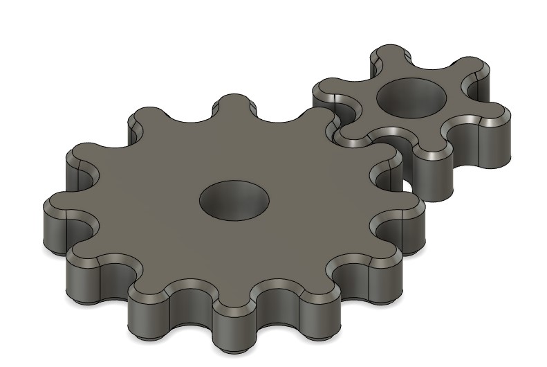

Hi All,  I'm wondering if anyone can give me any input on creating a simple custom gear/arrangement that I can change parametrically. The goal being to be able to change the tooth count and shape of teeth on the fly without having to redraw everything over and over. Im just not that good yet at constraints and perametics    ;  {
2nd requirement is that the gear shape needs to be pretty close to what I have already, as the larger gear is actually a thumbwheel that will be turned by your thumb to make setting changes to a machine. SO the gear needs to feel confortible when turning by your thumb or finger.
3rd requirement is the final gears need to be CNC machined from top and bottom ONLY in aluminum and are quite small so I will need to finish with 1/8 end mill to get into the pocket without any axial undercuts of the gear teeth.

etfrench
You'll need to change the pitch diameter of one of the gears in order to make them fit with the same amount of backlash. The tooth circles on each gear need to be tangent.  You'll also need to decide how much backlash is needed to make a smooth running gear.
In this sketch, the smaller gear was designed with tangent circles. The common tooth circle between the two was patterned on the larger circle.  As you can see they are not tangent with each other.
ETFrench

BillGEGHV
For the large gear did you purposely draw them without tangency in order to get the offset space? and are you able to change the number of teeth on this with everything updating?
When you did the pattern are you using the pitch di curve to array the circles on top of? IF yes I did not know you can do that in Fusion. In Rhino its array along curve.
This is exactly what I did in Rhino to get this 1st version, but without any parmatics and not really even considering the math. NO Pi was used when creating them lol, I just kept tweaking the circle sizes and spacing till I got something that seemed to work.
I think I just need to draw in Fusion it and just figure it out.

etfrench
Here's the parametric version. Since the tooth and the valley are modeled as separate circles, the circular pattern tooth counts must be even numbers.
Here are the parameters:
And the screencast:
ETFrench
Message 12 of 28
etfrench
p.s.  The tooth size for the pinion gear was set by dimensioning the radius of the pitch circle (circle not shown).

BillGEGHV
God, I wish i would have gone to mechanical engineering school and got that degree "backup plan" as my dad suggested. BUT NOOOOOOO I wanted to work in the movies and be a special effects make-up guy. "all self taught" this is feeling so beyond me. LOL What do I need to really understand to make this work. Im 1/2 way there? I think? 20 years using Rhino has done me no good, but when you get to the point you understand perametrics it is the most rewarding thing ever!
Once I get the pinion gear to where I like it I will probably not need to change it as I'm already locked in based on my end mill diameter and the internal room I have to work within my mechanism.
So this is what I have so far, but I'm stuck at this point. I can change the tooth count on the fly but that is just simply using a circular array. no biggie and not exactly what I need.
I did don't think I mentioned it but when I said update when adding teeth I also meant the overall diameter of the gear needs to update at the same time. Which etfrench you have done exactly what im looking for. Probably took you 5 min. I'm tempted to ask you to share your design BUT that would not do me any good in the quest to understand and be able to do this on my own. I DO appreciate the mock up design and effort you've put in. Thanks
SO, the question is what am I missing in my sketch? Im focused on the large gear at this point that is really the gear I need to do multiple iterations and prototypes to see what works. How do I constrain the overall diameter / "pitch diameter" to the tooth so they both update when making tooth count changes OR a change to the pitch diameter? I do realize that making random diameter changes would actually change the tooth diameter as well and is not necessarily the workflow I would follow, again the pocket needs to be a bit larger than 1/8 di for the end mill to fit in there for finish passes.
How can I share just the gear geometry with you guys? I've never parted out a design like this to share only 1 or two components. FYI the gears are separate components. Would I have to make a copy of the file and strip out all but the gears?
etfrench let me ask you something. When editing parameters did you customize the table in any way? OR are you just opening it up and changing the tooth count? What I want to understand is is there a need to be able to do expressions and customize the parameters to make this work?
