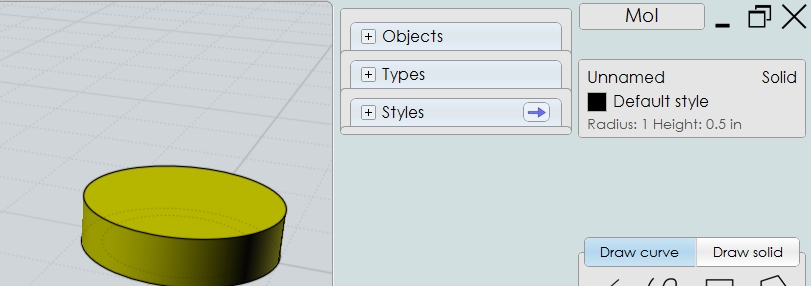

Not sure I follow what you are trying to say, so I tried the process myself.
I made a cylinder 1 inch radius in Moi with the units set to inches. I saved the file. (pic 1)
I uploaded the file into fusion 360. Note: The units shown depend on the units of the file you create in fusion 360 not the file you import.  The file you import just becomes a component of the fusion file.

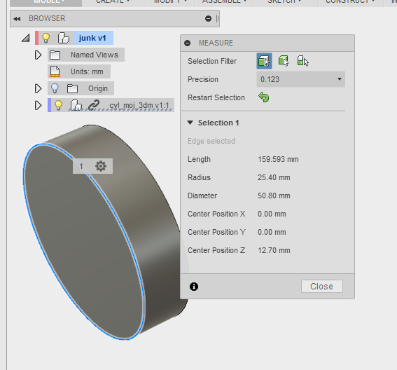

1st fusion file had mm units and the cylinder came in at the right size but with mm units displayed (pic 2)
