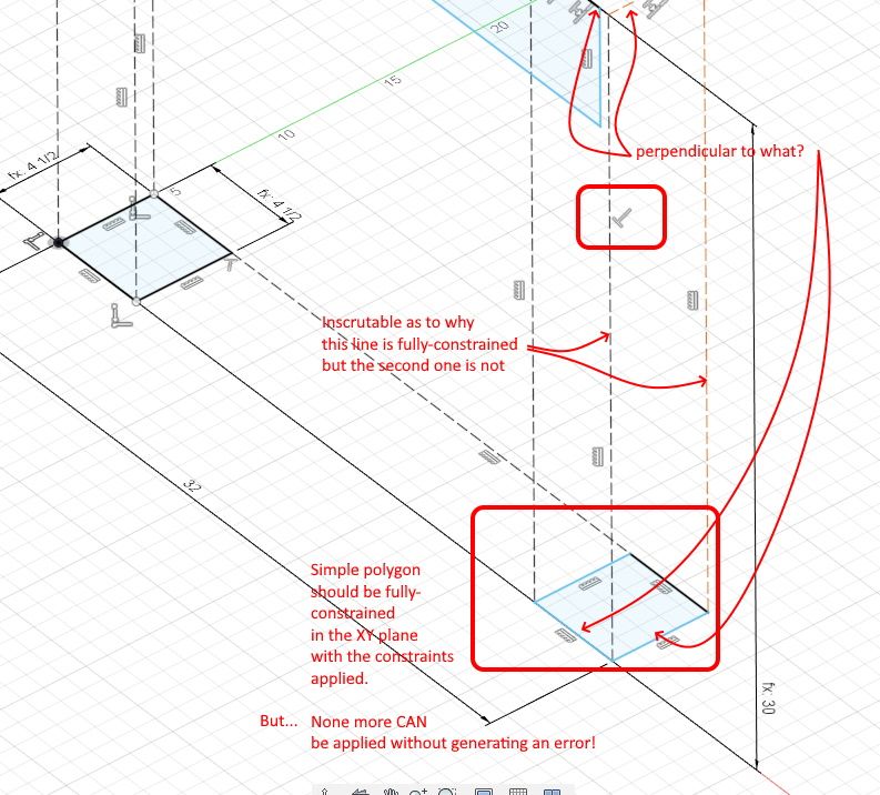

Yep the August 2021 iteration of 3D sketching still leaves something to be desired, in terms of significant workflow ambiguity for reliably constraining a 3D sketch, which after three days of head-pounding, still remain an elusive mystery to me.
1. There seems to be an implied sketch plane that needs to be respected. In the example shown, when constraining the legs of two rectangles, one from the XY plane and the other from ZX along a common line (in this case the x-axis) it's seemingly a crapshoot which plane the perpendicular constraint lands on, and which line out of 4 possible candidates it's actually referring to. Further, to my knowledge, it is not possible to deterministically evaluate which pair of entities are bound by ANY sketch constraint.
2. Often after a 'sketch is over-constrained' error, ALL 3D sketch constraints become unselectable and the only recourse seems to be restarting the sketch-edit session.
3. Inscrutability, simple polygons, even on the XY plane, become impossible to completely constrain as verified by turning black,  DESPITE all line & point entities being IMMOVABLE via either dragging or the move command. And yes, I am CERTAIN that all entities are on the XY sketch plane!
As much of the pain it is to overlay 2D sketches using construction planes, workflow disambiguation still seems well-worth it at this point.
Prove me wrong, please, as this feature would be a real timesaver!
Message 25 of 27
TheCADWhisperer
Please Attach your file here.

bwnicholspe
UPDATE: Turns-out two or three of the points at the corners of the rectangle were NOT constrained along the Z axis -- discoverable only by selecting the points and vigorously agitating with the MOVE command. Suggest perhaps a 'Check Constraints' utility highlighting ALL entities (including points) which are NOT fully-constrained, or some visual cue in the UI indicating that segment endpoints are unconstrained.
But I stand by my comments that
1) It is not always possible (yes, now I see the color-changing on-hover behavior) to determine which pair of entities are bound by a constraint, particularly COINCIDENT constraints. By extension, it sure would be handy to be able to EDIT a constraint and thereby change one of the bound entities without blowing it away and starting-over, which may or may not entail first determining the implied sketch plane it was drawn upon.  And...
2) Constraints selectability mysteriously goes dark, requiring a restart of the sketch-session.
Lastly a pedagogical observation, when starting out with 3D sketching it seems prudent to limit the types of constraints used. Perpendicular, coincident,  horizontal-vertical, co-linear and dimension will take you pretty far on orthogonal projects. Master a couple of simple orthogonal say tooling or backyard designs to get a feel for capabilities and limitations.
