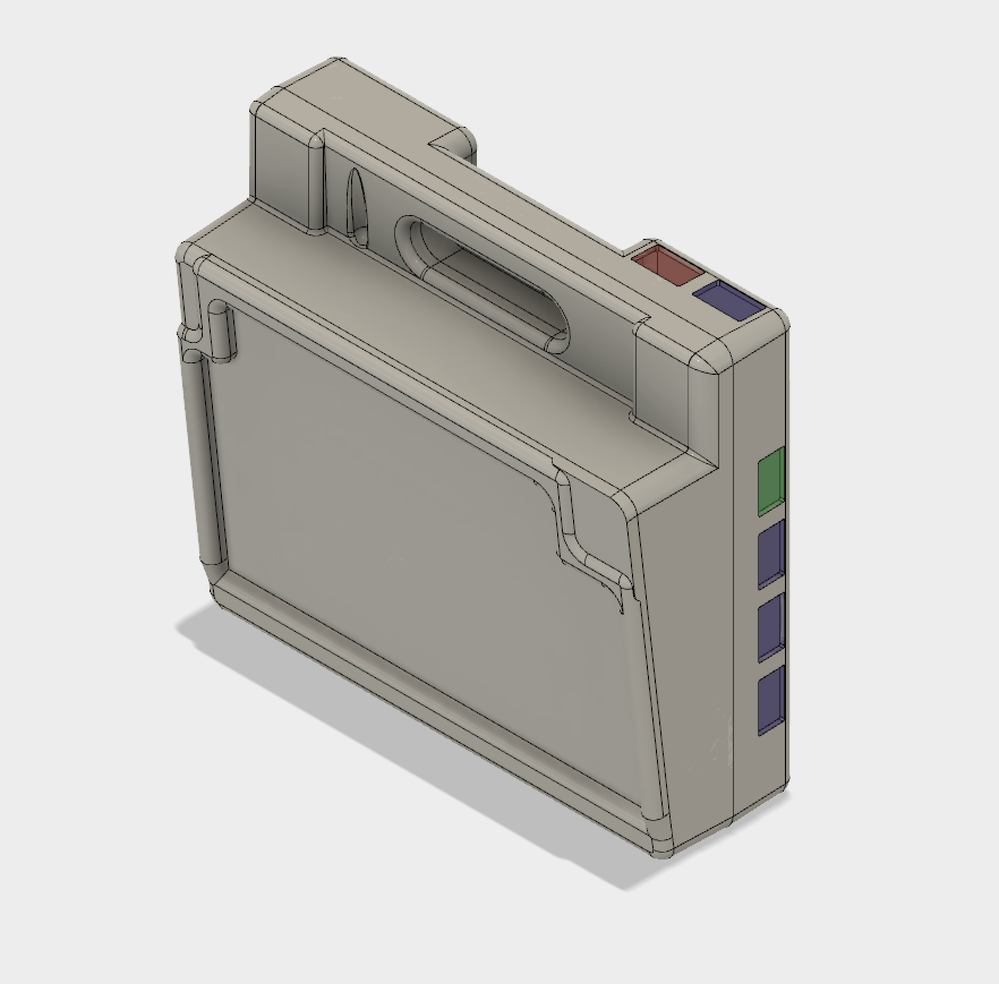

Hey guys. I'm not sure why this thread picked up interest again after I initially posted it some time ago, but I'm glad to see that it has and wanted to provide an update. After this discussion above and some more investigation, I ended up getting an EinScan Pro and have now successfully used it on a few reverse-engineering projects in Fusion. I'm astonished by the scanner's accuracy (entirely sufficient for the type of work I do) and generally pretty happy with the Fusion workflow.
Fusion tends to be a little crashy (at least on the Mac) when using scan data—even after significant mesh reduction in MeshMixer—but other than that it's pretty smooth sailing, especially with the Mesh workspace tools that allow tracing a mesh's intersection with a plane to a smoothed sketch curve.
An example would be the below carry case (an original sci-fi TV prop that we're replicating), where we chose to idealize the geometry slightly to make it symmetrical (etc) but wanted to follow the original geometry as much as feasible.
This will be used to create a vacuum-forming mold and allowed us to work completely non-destructively with the (somewhat valuable) original rather than having to do silicone casting against the interior.
I've also used it for tighter-tolerance applications where I built a CNC-machined housing in Fusion around a 3D scan of a computer keyboard plate and PCB, and it fit the actual part perfectly.
I haven't yet gotten into really complex compound curve modeling with reverse-engineered objects, but per @cekuhnen's comments, I think the limitations there are more in the realm of inherent Fusion limitations not the scanning workflow per se.
