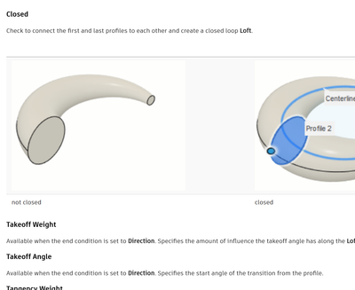

is to read the documentation. The Loft reference in the documentation:
https://help.autodesk.com/view/fusion360/ENU/?guid=GUID-EC6CECCD-55C1-4B08-95E4-5B1EEDE78D07
found simply by searching the documentation for Loft, which actually SHOWS almost exactly
what you are asking assistance for. The diagram below is a screenshot from the documentation
that looks very Elephant Tusk like to me.

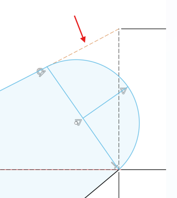

Blue lines, arcs and white dots should keep you awake at night...
Add a Horizontal Constraint between these two points.
Add the two radius dimensions to the arcs (just accept the default for the R34.47).
What do you notice about the color of the arcs?
Message 9 of 20
TheCADWhisperer
@3D_Ken
Delete this blue arc..
Replace the arc with this 3-Point Arc.
Add Tangent Constraints (if needed - Fusion might automatically add one or both of them for you)..
Click on the vertical line and push x key on the keyboard to change to Construction linetype.
Now add these to lines to the arc as shown below.
Then Attach your progress file here for next set of steps.

The number one tip in parametric CAD sketching - when geometry doesn't constraint - click, drag and observe.
When I drag this "vertical" line at the Origin - I observe that it is missing a Vertical Constraint.  Well, let's add that.
Then at the other end I observe a brown arc isn't constrained and wasn't in the original, let's delete that brown arc.
Now that I have deleted it I observe that I have lost the Tangent and have a white dot...
Message 12 of 20

TrippyLighting
A white point in a sketch indicates that the end point of the sketch object isn't fully constrained.
Message 16 of 20

Dashed line is not black.
Click and drag - what do you observe?
White dot.  Click and drag.
What do you observe?

It has taken me way too long to understand white dots and black lines, but I think it has finally sunk in.  I fixed the two points and the lock symbol has appeared.
I did look at the 2nd video, but I did not want to proceed until I cleared the lock problem.  I will now go on to the next step.
