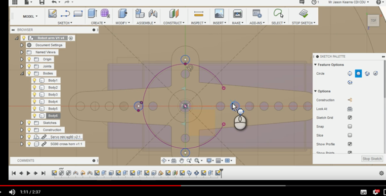

I press on the first red dot but the semi circle not show up  as the lesson on this video

The projected semi-circle appears to be irrelevant to the task. The third point clicked on the small circle appears to be coincident with the larger semi-circle, so Fusion 360 is projecting the semi-circle.   I'm not sure why the author is using a three point circle to create the circles on the top sketch.  A simple projection would work better (assuming the circles are actually circles and not ovals).

I think the difference you see is because Auto Project edges on reference default setting is now off, in the past it was on.
 If you want it enabled look in preferences. Most experienced users turn it of and only project what they need. Also pretty sure whoever made the video could have pressed P and projected the circles, but as @etfrench  mentioned maybe they were not true circles

YES ,  before nothing appear to me so I do what they till me and it work but  then I could not do the red circle , so that im asking .
anyway thank you for helping me
it is work now

Should mention the red semicircle that gets projected is a mistake and is a good example of why you'll probably want to turn auto projection off with a bit more experience.
You can see a bit earlier in the video the edge from one of the parts below the sketch is highlighted when the mouse pointer passes over it. The person making the video accidently picks that edge rather than the third point on the small circle. If this is your teacher they need a few lessons themself!Man Wink
