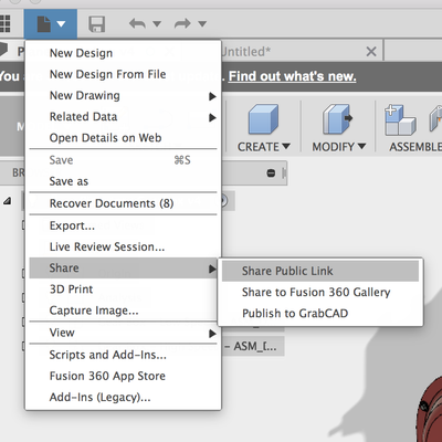

Hi @Anonymous, thanks for reaching out to us here on the forum. Unfortunately, I'm not able to reproduce this issue. If you could share your design with me, we can dig into this issue for you further. To share your design, just grab a public link and send it to me here or via email directly (timera.hart@autodesk.com).

I reproduced this issue just creating random geometries and changing the Top View using "set this view as ..." on the cube in the 3D model.
Anyway, here is the public link.
http://a360.co/2k8yD5Z
Stefano
