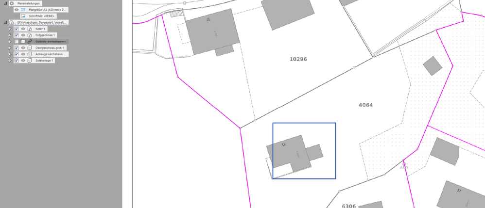

So what is the solution now? I actually need a background image. I even tried putting it on the frame (edit frame) but even then the image is in front of the views which is... (sorry) stupid.
What's my use case? I have to include the original land register map and wanted to use the views from Fusion360 to easily get the outline of my house without having to redraw it in another tool. Which I'll have to do now, but then I have to do this again each time the outline of my house changes. 😞Unbenannt.PNG
