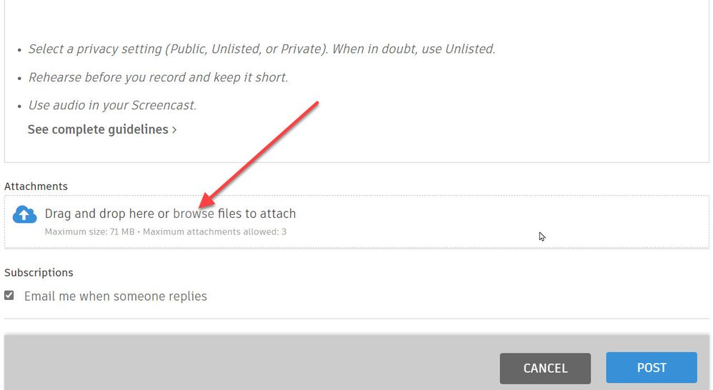

Can you attach your model real fast, it is getting late but I do a lot of molds and would like to help.  If you do not know how to attach your Fusion 360 model follow these easy steps. Open the model in Fusion 360, select the File menu, then Export and save to your hard drive. Then use the Attachments section of a forum post to attach it.

i can not get the file to attach
