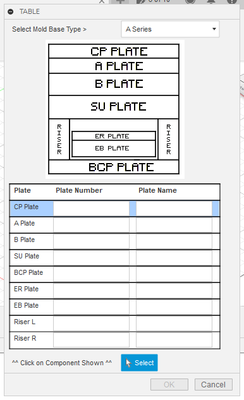

Problem 1: As shown in the picture below, the input boxes do not line up properly with grid.
Nor do the words under "Plate" stay centered in the grid. They keep moving lower and lower.

Problem 2: Next, I click on row 1 in the table, "CP Plate" then click a body in the mold base which fills in the blanks with the current part name and number.
I fill in the blanks with what I want the part number and name I want it to be.
When I am satisfied with my in put I click on row 2, "A Plate" and click on the A plate in the assembly.
When I click on the next "A Plate", it fills in the blanks as before, but deletes row 1,
Every time I change rows and click a different plate, it deletes the previous plate no matter what order I have clicked on them.
Th following is the lines of code I believe is the problem.

Hi @brad.bylls ,
I believe the rows misalignment problems is due to the TableCommandInput's rowSpacing property which is set to 1 pixel by default.
If you set to 0 pixels, it will look like so:
You just need to add one line to you table definition section:

Hi @brad.bylls ,
You don't need to delete and re-create the command inputs; just changes its values like so:

It worked for me:
Hope this could help.
