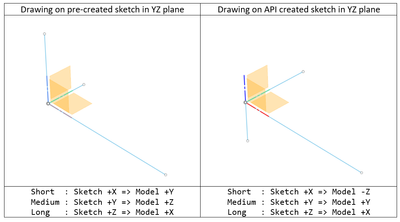

Appologies, but I missing the logic. And why UI created sketches beahve differently from the API created sketches.
I had to reread this explanation several times before I understood the difference between sketch coordinate and model coordinate system.
I therefor added a bit of extra code to try and understand (see below).
Allow me to add some pictures.
 XY Plane is logical.
XZ is not logical.
IMHO, the sketch's +Y should align with the model's +Z.
When editing a UI created sketch, the models X and Z  are graphically properly oriented for the view, that is horizontal to the rigth for X and vertical and up for the Z. So you would expect the sketch X and Y to follow that, but no, Y is negative. The other planes do follow a correct orientation.
At least UI and API created orientations are the same.
YZ is also not logical and here UI and API created sketches follow different rules.
Sketch +X should aling to model +Y and sketch +Y should follow model +Z .
These differences make it hard to program something thru API as it differs from UI interactions.
