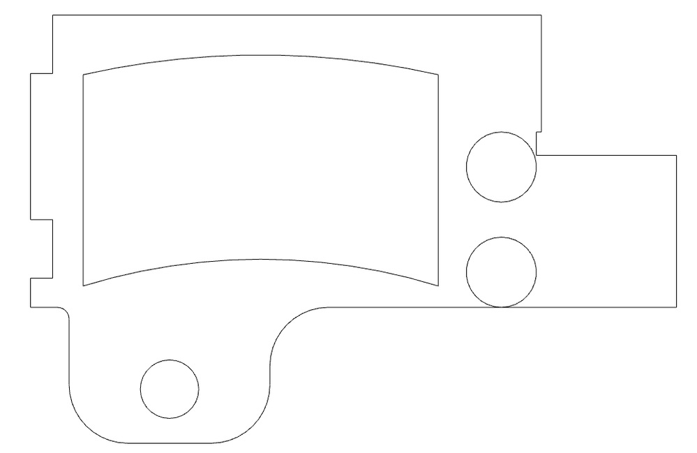

This is really a follow-up to this thread, but the subject has morphed into something a bit different.
Is there any standard guidance on creating surfaces of the following type using TemporaryBRepManager.createFaceFromPlanarWires?
The issue is the circle that is tangent to the outer edge. In the curve set, there is in fact a vertex connected to 4 edges. Just to be clear, the result I would like is something like this:
It doesn't matter to me if the circle is represented as an interior loop or as an incursion on the outer profile. However, Fusion 360 doesn't like either of these options as input. If the circle is a separate loop, Fusion 360 complains that the wires "intersect or touch". If the circle is included as a detour from the outer contour (in either direction), the complaint is that the "cover failed to make a surface". ("No, you," I want to retort. "You failed to make a surface." 🙂)
There is an allowSelfIntersections option to TemporaryBRepManager.createWireFromCurves, but it doesn't seem to make any difference. The errors are the same with or without that.
Oddly, the Patch command seems to have no trouble creating this type of surface from a sketch profile. Strange, because it seems the only thing backing up a profile in the API is a set of curve loops, exactly the input I'm already supplying.

Hi @GRSnyder .
I hadn't made any assumptions about tangents.
The only other way I can think of is to create a patch with TextCommands.

Even in other 3D CAD systems, I don't think it is desirable to have the boundaries of a surface look like the first image.
(It might cause problems.)

Here's my guess at what's happening.  The createWireFromCurves is a simple method that takes in an array of curves with not specific requirements of how the curves exist in the array.  It's doing to work to determine how they're connected and building the B-Rep topology for that.  Where you have multiple curves connecting at a single point, it is ambiguous how the curves should connect.
I didn't try it but I think you might be able to use the BRepBodyDefinition function in the API where you explicitly define the full B-Rep data to create a body.  Using this you provide a complete definition of the loop that bounds the face and any interior loops.
Here's a sample from the online help that demonstrates its use.  It's not simple to use but it is quite powerful.
http://help.autodesk.com/view/fusion360/ENU/?guid=GUID-ca29fec6-6d94-49bb-b4cd-de77c782011a

Thank you both for the comments. I will investigate both of these approaches.
As for the suggestion that forms like this should be banned from CAD, I quite agree! And yet, there it is... 🙂
