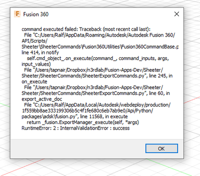

iUser2k13
connection to sheet works, but problems to export STL files.

Hi folks,
Hope everyone is doing well. I recently downloaded the sheeter add in and followed all steps to integrate it with Fusion, which I believe I did correctly. Yet, when I try to sinc with the google sheets, I get the error in the attached picture...
Any help would be appreciated!
Message 20 of 65
Nevermind! I just restarted Fusion and now it is working!
