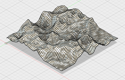

I've created a script for Fusion 360 that can be used to import an image and convert it to a mesh, sketch points, or sketch lines.
The following heightmap image of a portion of the moon was used to generate the following mesh and then t-spline:
The t-spline version is the most flexible for changes and it can also be used in the CAM environment for milling.
The code and information is posted on Github:
https://github.com/hanskellner/Fusion360Image2Surface
Note, because of limitations in Fusion on the size of meshes, I highly recommend using only very small images. For example, the moon image above is only 50x50 pixels. If you have an image that's large then create a smaller version of it then import that.
