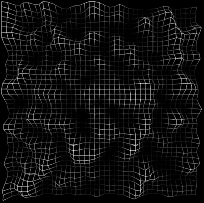

Image 2 Surface Script for Fusion 360
hanskellner
I've created a script for Fusion 360 that can be used to import an image and convert it to a mesh, sketch points, or sketch lines.
The following heightmap image of a portion of the moon was used to generate the following mesh and then t-spline:
The t-spline version is the most flexible for changes and it can also be used in the CAM environment for milling.
The code and information is posted on Github:
https://github.com/hanskellner/Fusion360Image2Surface
Note, because of limitations in Fusion on the size of meshes, I highly recommend using only very small images. For example, the moon image above is only 50x50 pixels. If you have an image that's large then create a smaller version of it then import that.

Thanks for creating this script. It is great to have this functionality.
Perhaps this is some mistake in my configuration, but the surface mesh that is generated on my system always consists of triangles. Since it's not a quad mesh, the Fusion 360 will not convert it to T-Spline body, which I would like to use further in my workflow.
I'm wondering how to fix this? As a reference I have included screenshots of the surface I'm working with. The preview in the Image 2 Surface GUI seems fine, but the result after it's sent to the Fusion not anymore.
Image 2 SurfaceImage 2 SurfaceFusion 360Fusion 360
Message 69 of 80
hanskellner
I've just done a test and verified that the surface is correctly created within Fusion using quads and not triangles.  I would like to better understand your exact workflow.
What workspace are you in when you launch the Image 2 Surface add-in?  I'm assuming the Model workspace as the add-in should only run when that is active.
If you try another image, do you still get triangles on generation?  Note, there's the sample "resources/MoonHeightmap.jpg" in the Image2Surface add-in folder that you can try.
Thanks.

I'm launching the Image 2 Surface GUI from the Model workspace, immediately after starting the Fusion 360 and running the add-in from the "Scripts and Add-Ins" dialog. (I verified that I indeed cannot launch it from different workspaces.) Capture of the Design History is on. There are no other special add-ins or scripts that I'm using.
As you suggested, I tried the "resources/MoonHeightmap.jpg" and "resources/samples/penny_depthmap_500-sm.jpg" images, and got the same behaviour as previously - only triangles on generation in both cases.
Message 71 of 80
hanskellner
Ok, I think I know what might be the issue.
There is a Mesh setting in the Fusion 360 preferences to triangulate mesh polygons.  I'm guessing that you have that setting enabled.  Try unchecking/disabling that setting then creating a surface.
Hans Kellner
Senior Manager, Principal Engineer
Message 72 of 80
That was it! Thanks a lot for your help!
