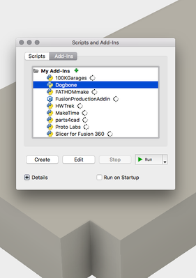

Message 32 of 34
bplabmac
in reply to: daniel_lyall
I have the same problem or similar
I installed this api in the right folder, when I check it in Fusion window, it appears
but when i want run it, it does not work
I have Mac 10.11.6
I have a same problem with Nester script
any advise ? thk very much by advance

in reply to: casey.rogers
Hello I have been trying to add it and it shows in the add ins and shows its running but nothing shows up. I know a new menu should show up but nothing happens. Its it hidden somewhere. Do I need to turn something on. I got it yo work one time. I started to mess around with it and accidentally removed it from the toolbar. Ever since then I have removed and reinstalled it over and over. Even reinstalled autodesk. No luck! Please any advice would be great. Thank you
