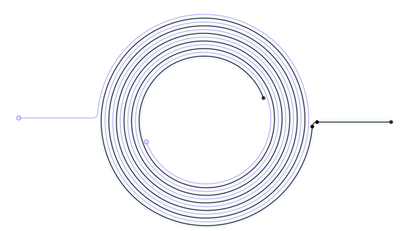

pl.fauny
Hi @kandennti ,
Thank for your help and your time.
I made your scrypt works with your file curve.f3d.
But with my file (spiral.f3d), I've got a strange behaviour :
I use different way to make the spiral. Maybe that why it's not working on mine. I use a tolerance variable of 0.05.
If you have any idea...

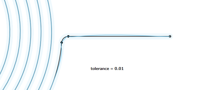

Message 5 of 14
pl.fauny
@kandennti,
Thank you for the update.
Unfortunatly I loose to much precision on this version around the fillet. If the fillet get bigger, it's just convert as a chamfer.
This spline will become an electronic track in an other software, so I need to keep some accuracy.
In any case, you went much further than I could 😉 Thanks

It's a little better, but not much better.
I have also noticed that the arc part is not correct.
So I made a sample with only multiple arcs and tried it, and made it display the points as well.
The results were different depending on the arc selected.
I suspect that the cause of this is that the passage point is not calculated correctly due to the relationship between the start point and the end point, but I have no idea how to deal with this.
Message 7 of 14
pl.fauny
Hi @kandennti ,
I have no idea neither or the competences to deal with this problem.
In an other hand, I had the same problem with svg files that are makes with multiple selection lines, and your srcypt make a perfect feating job in this case.
Here a view of one letter from a SVG file where original svg lines in green and post processing line in blue are perfectly feating.
So you made it works for a half of my problems 😉 Thank you.

pl.fauny
Hi @BrianEkins ,
It works very well, thank a lot !
One thing interesting is that make a 180° rotation.
In the case where I'm working in a sub component, the new sketch is created in the main project.
But those are just small details 😉
Thanks both of you @kandennti and @BrianEkins for your work and your time to provide me this good solution !

It works like a charm with the worldGeometry update !
Thanks @BrianEkins and @kandennti 🙂
