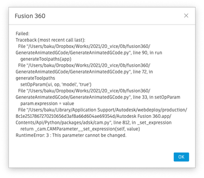

I'm trying to automate a process to append several CAM operations with Python API,
but got the error "This parameter cannot be changed" when setting an expression to parameters with selection input type (e.g. Model Surface on Geometry section).
Is there any way to set a mesh selection value for this kind of CAM parameter?
FYI here's the code that the error was thrown.
param = operation.parameter.itemByName('model')
param.expression = 'true' # Trying to set a mesh selection but don't know how to specify it with string.

The ability to define the geometry associated with an operation is not yet supported by the CAM API.  I don't know when it will be available but it will open up a lot more possibilities.

Nothing to support this has happened yet.  I don't know what the plans are as far as when it might happen.

It's not supported at all, regardless of the language.
