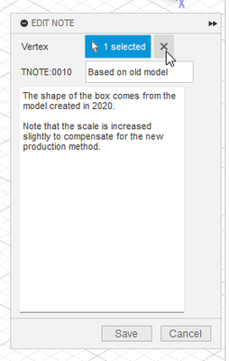

I think (hope) it is a good term, but let me try to explain what I mean by it.
Here we see TNOTE:0010. It shows up as white point on the corner of the slab. The mouse cursor is next to it. This uses Fusion's built-in graphics.
Now I hit Toggle Overlay. The dot is now "overlayed" by a lilac marker. (English is not my first language, so it might be the wrong word for the color.)
Moving the mouse over the overlay marker pops up a box with the contents of the note.
If I hide the note using the eye button, the white dot will disappear. So will the lilac marker.
Some additional info:
As this is a "Timeline Note", it shows up in the timeline. This is the note type that is available for putting notes on bodies (on their vertices).
I choose to implement notes as a feature (as in "Extrude feature") because a) I have seen requests for notes in the timeline and b) visibility on the model. At the start, I did not have the overlay functionality, so then the white dot was the only way to see the notes on the model. Finally, the white dots will be visible to someone without the add-in, but they will not be able to read the note text - just the title.
If I deselect the vertex in the note edit dialog, the note will be attached to the component's origin, but set to not visible (same as the "eye button") by default.
Finally, sketch notes has no feature counterpart in Fusion, so they are always rendered as "overlays" as they would otherwise be invisible - whether the user has turned overlays on or off. (I should probably clarify that in the command name. Maybe "Toggle Timeline Note Overlay")
I'll see if I can update the documentation text to be more clear. It's always easy to miss explaining things when being in the midst of it.
And feel free to suggest a better term - or say if the functionality seems counterintuitive. 🙂
