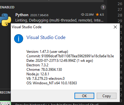

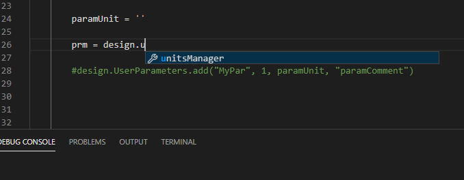

Intellisense seems to kind of work but of the hop I was trying to access, edit, add userParameters. My code I found to add a user parameter
 design.userParameters.add("MyPar", adsk.core.ValueInput.createByReal(5*2.54),"in","")
worked after much research and scouring the forums but I could not get the userParameters to populate after typing design.us <Ctrl+Space>
My VSCode was installed using a one click installer for FIRST Robotics to program primarily Java. It is possible I could be missing key Extensions
I followed the post What-is-the-path-to-fusion-360-api-internal-module-adsk But nothing changed. Some Intellisense does work like with the above design.parentDocument and a few others do populate the list.

Hi @Anonymous .
I don't know why IntelliSense doesn't work, but I do know how to make it work.
If you use a cast or Type Hints, it should work.

Message 5 of 9

I second using "cast".
@AnonymousDid you try using cast or the type declartion? It does not look like that in your screenshot. I have always had to use cast() for e.g. design.
Then again, if it should work without cast, then it's a bug.

@thomasa88 I'm not 100% on how to cast() this. Do you have an exsample?
Here are a few screen shots of some Intellisense working: but you see the
UserParameters dose NOT populate.
